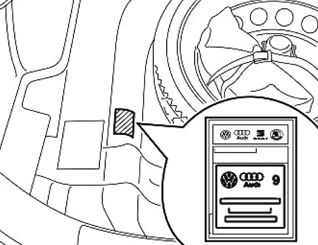

If the vehicle is listed in the system as not completed, check whether a campaign sticker with the entry "23H9 date/stamp" is attached in the spare wheel well area (next to data sticker):If the campaign sticker is attached, the campaign has already been performed. Make the entry “23H9 date/stamp” in the service schedule under “Space for workshop entries”.
If the campaign sticker with entry "23H9" is not fitted, carry out the work according to the repair instructions.

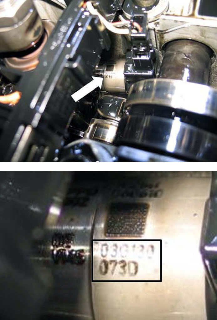

Identifying the potentially faulty injectors.
Remove cam cover and check the part number –see arrow- on the pump injector element. All pump injector elements with the part number 03G 130 073 D or 03G 130 073 M must be replaced. All other pump injector elements are correct and must not be replaced.
